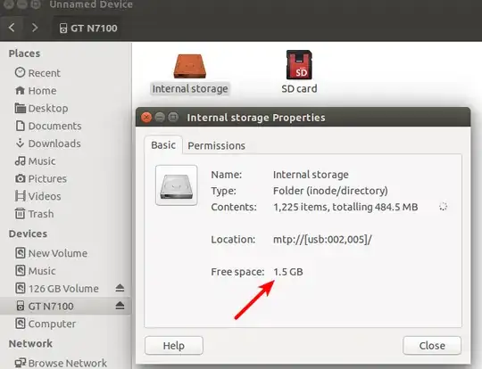

I don't know how to show the total free disk space from the command line though. You can see it from the GUI: right click > Properties.
