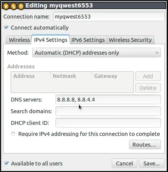

Fourth go into network manager at top right corner of the screen and click on edit connections>wireless tab and set IPV6 to ignore and change your dns server to google according to the screenshots. DNS SettingsIPV6 Setting
Then reboot.
