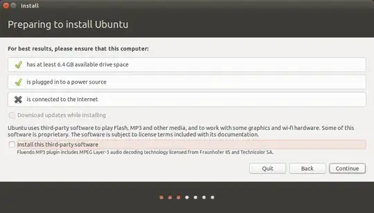

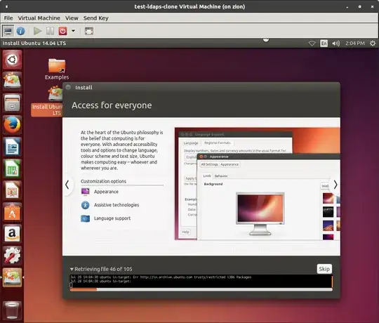

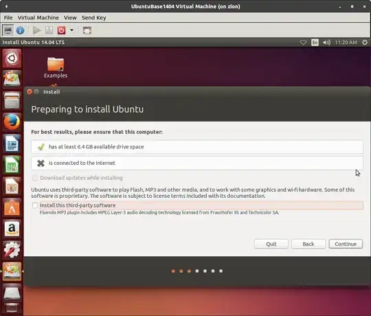

Here are a couple of screenshots from a test on a VM:
Disabled update selection for a VM Fetching mirror information fails

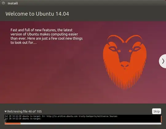

Here are a couple of screenshots from a test on a laptop:
Note the usage of in.archive.ubuntu.com, even though, following @noleti's advice, I had set ftp.iitb.ac.in as the mirror:
Disabled update selection for a laptop Fetching mirror info fails on laptop apt-update and sources.list

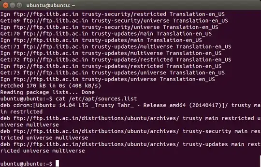

It depends on whether ubiquity is using /etc/apt/sources.list for the install
Possible solution: manipulate /etc/apt/sources.list
During installation, you should be able to edit the /etc/apt/sources.list (as root) to redirect to your mirror.
deb ftp://ftp.iitb.ac.in/distributions/ubuntu/archives  trusty main restricted
deb-src ftp://ftp.iitb.ac.in/distributions/ubuntu/archives  trusty main restricted
More info here. Then, run an sudo apt-get update.
By redirecting the call to the mirror
It might be possible to redirect the hard-coded communication with the mirror. Options for that: /etc/hosts dns manipulation to direct to another server with same protocol and directory structure, or by using a local transparent proxy. In your case, assuming you can set up the http mirror on the same machine as your ftp mirror: add the following line to /etc/hosts
103.21.126.20 in.archive.ubuntu.com
