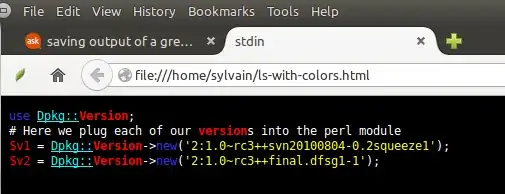

To keep the markup, you need more than just a text file. I'd use HTML output to keep the colors.
  • Install aha i.e. to "converts ANSI escape sequences of a unix terminal to HTML code"
    sudo apt-get install aha
  • then save your grep (or ls) output like this:
    ls --color=always | aha --black --title 'ls-with-colors' > ls-with-colors.html
    options:
    --black param to set background as black color
    --title param to set the title for HTML page
Syntax highlight for file extension via pygmentize
  • install pygmentize:
    sudo apt-get install python-pygments
  • then run this kind of command:
    pygmentize file.pl | grep -i --color=always version | aha --black > ls-with-colors.html
