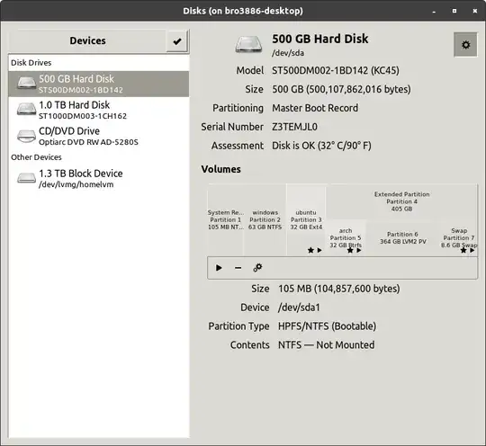

If it is a new hard disk, you can format it afresh, and start using it. Open the Disks program, select your new hard disk from the right hand pane, click on the gear icon in the top right corner, and choose Format. Disks screenshot
Use the default option (both GPT and MBR work fine). Once it creates a new partition table, click on the +, choose a size. For the type, if you wish to use it on Windows as well, select "Compatible with most systems (NTFS)" instead of the default (ext4). Give a nice label. Click on the play icon to mount it. (Or on the corresponding icon in the file browser.)
