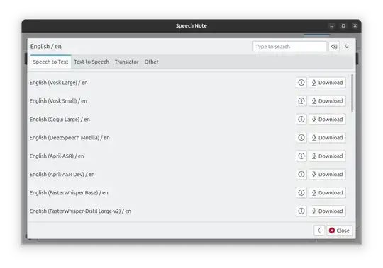

Speech Note
https://github.com/mkiol/dsnote
This project is front-end for a bunch of possible backend TTS and STT models on multiple languages. That is cool because with it you can quickly try several models on a given text to decide which one is better, without having to try to install a bunch of differently broken software systems. Trying:
flatpak install flathub net.mkiol.SpeechNote
flatpak run net.mkiol.SpeechNote
opens a GUI.
Then under:
  • Languages
  • English
  • Text to Speech
I can download a model. Just note that some of them require "voice samples" presumably to clone from, which might or might not be what you want.
f
Then you can type your text on the GUI an click the "Read" button to hear it.
And to save to a file:
  • File
  • Export to a file
