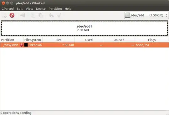

I have run GParted as superuser, with the partition not mounted. This is how GParted recognizes the drive:
partitions
And in the Information tab it is said
Unable to detect file system! Possible reasons are
 - The file system is damaged
 - The file system is unknown to GParted
 - There is no file system available (un-formatted)
 - The device entry /dev/sdd1 is missing
