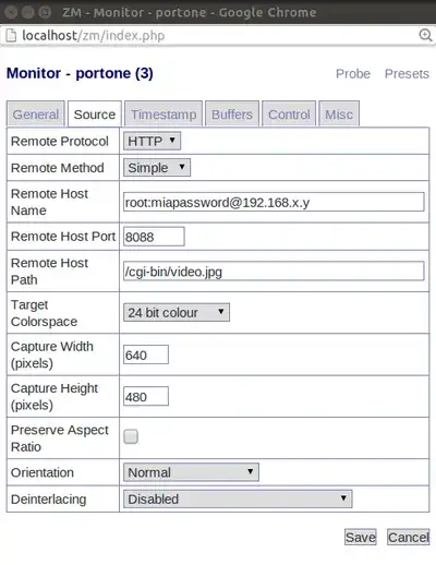

PROBLEM:
When in Zoneminder (version used:1.27.1) in the settings of your monitor, voice
Source tab as follows:
Remote Protocol: HTTP
Remote Method: Simple
Remote Host Name: root:miapassword@192.168.x.y
Remote Host Port: 8088
Remote Host Path: /cgi-bin/video.jpg
Target Colorspace: 24 bit color
Capture Width (pixels): 320
Capture Height (pixels): 240
but does not want to operate with a blue screen!
INFO AND NOTE:
  • I'm asking for help to install a Vivotek FD6122 IP Camera (manual at page 62 URL syntax: "http:///cgi-bin/video.jpg")
The camera works perfectly.
When I run its browser access: 192.168.xy: 8088/cgi-bin/video.jpg, it asks me:
user: root
password: miapassword
and I see the camera on quietly browser.
  • The VIVOTEK camera also works great from web administration panel (http://192.168.xy:8088/snapshot.vspx) and Android phone.
  • The behavior of browsers not working only in the VIVOTEK, only on Firefox by directly entering USERNAME and PASSWORD (method working on other IP cameras) root:miapassword@192.168.x.y:8088/cgi-bin/video.jpg
  • Zoneminder does not like USERNAME and PASSWORD to be empty. It is advisable to always use these two data otherwise, as happened in the other camera IP, does not display and shows the usual blue screen with timer and date working! As soon as I entered USERNAME and PASSWORD the other IP camera "magically" worked however, except for the "squeamish" Vivotek FD6122!
  • I did not find the model here Vivotek in Zoneminder. I tried the settings for the similar model (Vivotek FD8134) at the site of zoneminder
recommended settings Zoneminder (Vivotek FD8134):
Remote Protocol: RTSP
Remote Method: RTP/RTSP
Remote Host Name: Put in the cameras IP or hostname
Remote Host Path: /live.sdp
and both Zoneminder, both from the browser, but without success in both cases.
  • log files of the three errors are repeated continuously:
    **Date/Time,    Component,   PID,   Level,   Message,   File,   Line**
    2014-07-22 17:46:10.632456 zmc_m3 3574 ERR Failed requesting writeable buffer for reading JPEG image. zm_image.cpp 993
    2014-07-22 17:46:10.597513 zmc_m3 3574 ERR Held buffer is undersized for requested buffer zm_image.cpp 314
    2014-07-22 17:46:10.222009 zmc_m3 3574 ERR Unable to decode jpeg zm_remote_camera_http.cpp 1120
