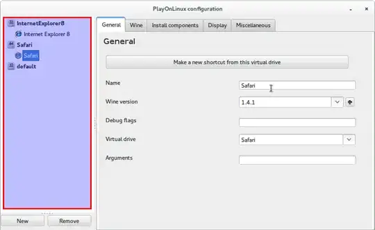

If you are using PlayOnLinux, you can check which version using the GUI - open PlayOnLinux, click 'Configure' on the relevant program, and look at the pane on the left:
Alternatively, you can do what winetricks does (in version 20140817, circa line 3600), which is check the wineprefix for the presence of the directory WINEPREFIX/drive_c/windows/syswow64, which should be found in 64bit windows/wineprefix, but not 32bit versions. This should work for ordinary wineprefixes and those under PlayOnLinux.
