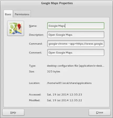

This is also possible by right-clicking on the launcher in most file mangers and selecting properties: enter image description here
Then clicking on the icon and selecting a new one - note if it is in /usr/share/applications you probably need permissions to edit the file.
