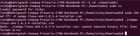

I was trying to install xampp into my ubuntu 14.04 LTS. I got guidance from this video to do that. But it wasn't working well for me. I got stuck at the middle. Help me get out of it. These were the steps followed by me to get it.
I went here and downloaded xampp version 1.8.3 for linux. And I proceeded with the following terminal messages.
Terminal Image
I would be highly grateful if I could install xampp in the same way as my video teaches.

The description and details about .run files are disscused in here What are .run files? the problem in your case is that you should run following commands
chmod 755 xampp.run[or any of your package name]
sudo ./xampp.run not
chmod 777 -R xampp.run
./xampp.run
see this for more info
you can download your package from one more method
add ppa
sudo add-apt-repository ppa:upubuntu-com/xampp
update
sudo apt-get update
install xampp
sudo apt-get install xampp
check this link for more help
also you should check if you have downloaded a correct file or not according to your hardware configuration like for 64-bit os you have downloaded x64 or i386 file
