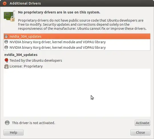

Edit 5
Here's my additional driver window :
Should I go ahead & enable 304 ?

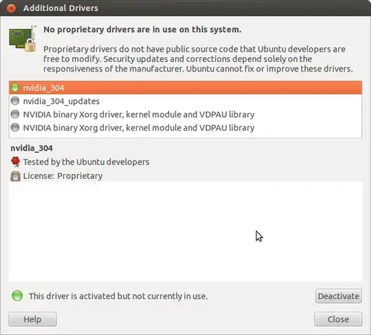

Edit 6
After running
 sudo apt-get install nvidia-current
as per one of the suggestions, the additional driver windows changed to :
Also :
$ sudo dpkg --get-selections | grep nvidia
nvidia-304                  install
nvidia-304-updates          install
nvidia-current              install
nvidia-current-updates      install
nvidia-settings             install
Graphics settings is still blank.

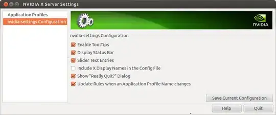

Running $nvidia-settings shows me :
What is left to do ??

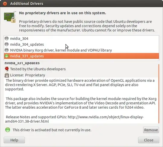

Edit 7
With no one replying ... I am installing the last entry in the list, and deactivating 304. Now I will try sudo nvidia-xconfig & a reboot. fingers crossed ..
