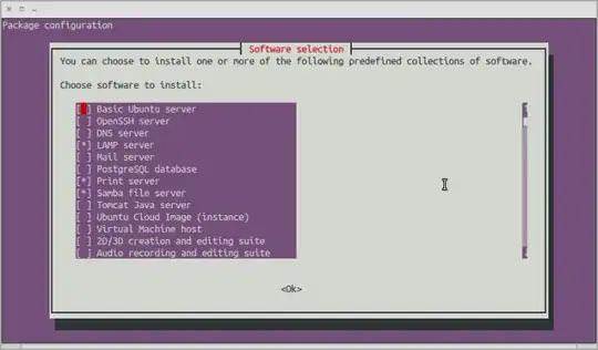

Open your terminal and type:
sudo apt-get install tasksel
Then type sudo tasksel in terminal
It will open in terminal with options & there you can choose Ubuntu Server with space-bar and then continue. It will download and install Ubuntu Server tools.
Hope that helps.
