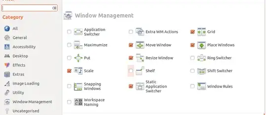

Or can be fixed by installing
  • Compiz
and enabling Static Application Switcher
sudo apt-get install compiz
sudo apt-get install compizconfig-settings-manager
you might need to install compiz-plugins-extra as well and then
ccsm
