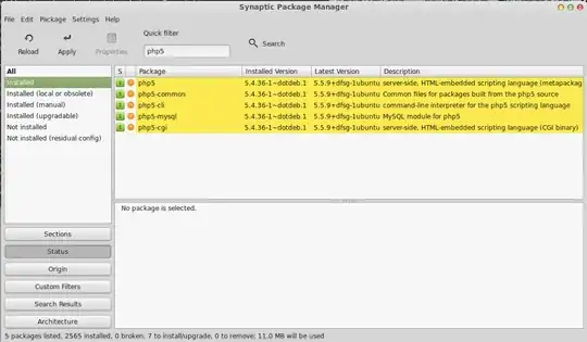

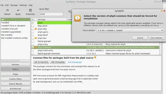

The easy way to install the specific version is via synaptic
all done
