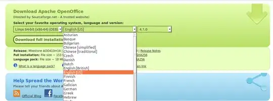

At this point, I downloaded the package in my desktop (in my case, 64-bit architecture and Italian language it) from here. enter image description here
