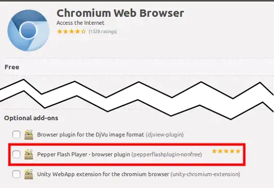

You can also use Chromium and the Pepper flash plugin:enter image description here

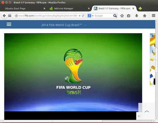

Other answers - which are better for Firefox users (like me):
  • Use FreshPlayerPlugin, which borrows the plugin from Google Chrome. Instructions for 14.04:
    sudo add-apt-repository ppa:nilarimogard/webupd8
    sudo apt-get update
    sudo apt-get install freshplayerplugin
    You can then open about:addons in Firefox, and enable the plugin under 'Plugins'. It may be easier if you remove the original Flash plugin first, as Firefox seems to prefer using that. It does seem to work (the usual Flash plugin doesn't):
  • Use Pipelight (instructions here) which sort of uses Wine to pretend to be a Windows machine.
