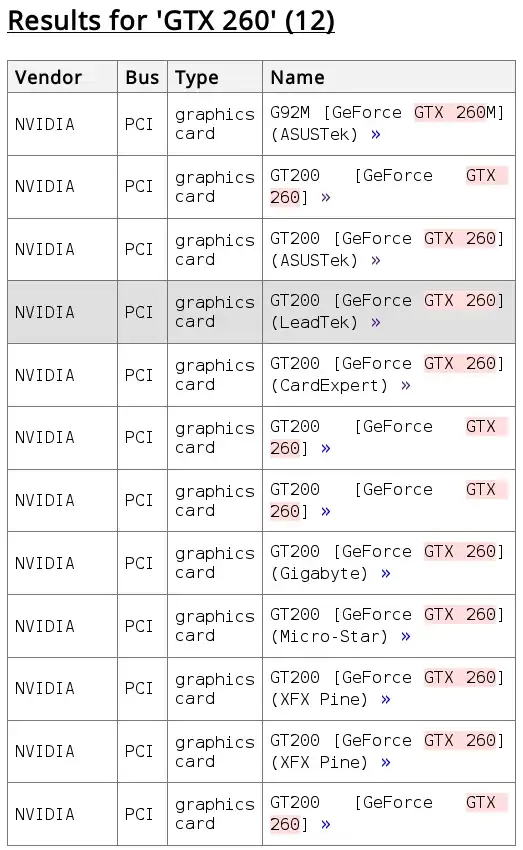

Try new Linux-Hardware.org database of Linux-compatible computers & devices.
Sample search for GTX 260 (mentioned in previous comments): https://linux-hardware.org/?view=search&name=GTX+260
Make a probe after assembling to check all devices: https://github.com/linuxhw/hw-probe
I'm the author of this project, so feel free to ask any questions in comments!
