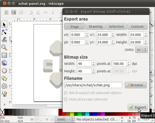

Create mono icons
Requirements
  • Inkscape
  • Administrator privileges (sudo, gksu, etc)
Method
  1. Open the terminal, type in gksu nautilus. This will launch Nautilus with superuser privileges.
  2. Go to /usr/share/, and create a directory called xchat there.
  3. Go to /usr/share/icons/ubuntu-mono-dark/apps/24/ and open up xchat-panel.svg in Inkscape (as superuser too, open from the superuser Nautilus Window opened in first step).
  4. On the menu, go to File, then Export Bitmap...
  5. Click on Page, then make the Width and Height input boxes have a value of 48.
  6. Click on Browse. Navigate to /usr/share/ then select xchat.png and save.
  7. Export.
Inkscaping the XChat icon
