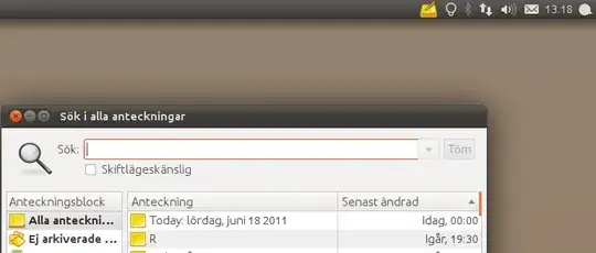

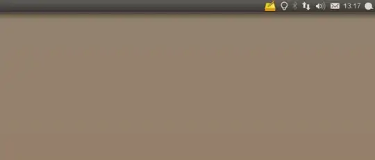

Two screenshots to illustrate.
What I want: Gnote starts minimized
What I get now: Gnote starts with search dialog open
