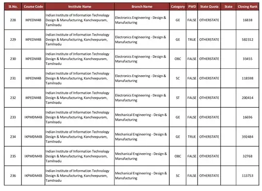

I have got a pdf file which contains a table which looks like
It contains about 2500+ entries and I have 3 days time.
So to do some smart work sorting out the right colleges for me, I need to match the contents to multiple regexp, like

I first tried opening it in libreoffice calc but it opens in libreoffice Draw. I tried pdftohtml and pdftotext but both mess it badly.
Finally I came at pdfgrep, but it does not work in combination with grep as,
pdfgrep regexp1 ./locn to file|grep regexp2|grep regexp3
gives error
Binary file (standard input) matches
So whatever I have to do is with a single regexp to be put in pdfgrep, which will match all regexp's that I need.
