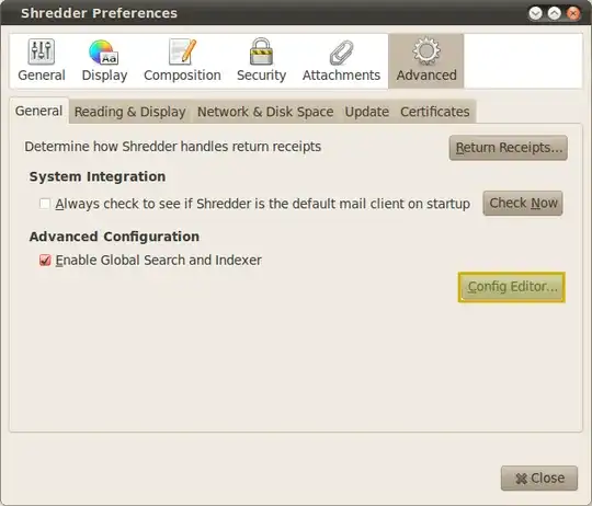

To disable compatibility checking for extensions, open Thunderbird's preferences, switch to the "Advanced" tab and in the "General" subtab, start the config editor. (source)
Where to find the Config Editor
Add a new boolean value via right click named
