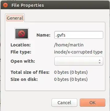

I recently made a fresh install of Ubuntu 14.04 and I noticed an item .gvfs in my home folder.
It is very strange, since it is visible even though it has a leading .
What is even stranger is that I cannot determine the owner of the file:
drwxrwxr-x  2 martin martin 4096 juil.  6 17:48 .gstreamer-0.10
d?????????  ? ?      ?         ?              ? .gvfs
-rw-rw-r--  1 martin martin   68 nov.  16  2013 .hgrc

It serves as mount point for GVFS-Fuse.
gvfs is a userspace virtual filesystem where mount runs as a separate processes which you talk to via dbus. It also contains a gio module that seamlessly adds gvfs support to all applications using the gio API. It also supports exposing the gvfs mounts to non-gio applications using fuse.Ubuntu Packages
Mitch
  • 109,787
This is a FUSE mount point. By default, FUSE will prevent other users (even root) from accessing your FUSE mounts. I believe that this directory was mounted under a different user, or you are viewing the directory through a different user.
See this question for an explanation
