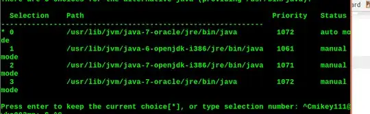

In a terminal session, run : sudo update-alternatives --config java
You will get a list that looks something like this:
As per the instructions at the prompt, enter the number corresponding to the version you want to be your system default Java implementation.
Once you've done that, unless there are configuration settings directing otherwise for particular applications (quite common), the Java version you've chosen will be your global system default.
