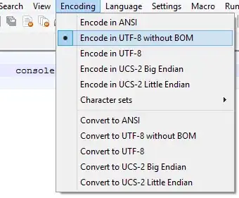

I have the file in a samba share and when I open it in Windows 8 pro it looks as so in notepad++:
notepad++
notepad++ encoding
