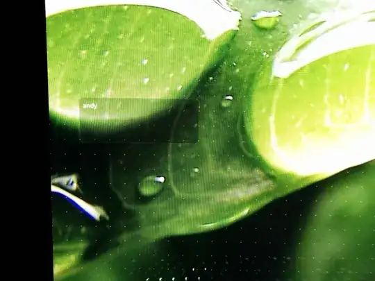

Occasionally my lock screen does this:
No password input
That makes logging in difficult. Restarting Unity kind of works, sometimes only a reboot will fix it. My video card is a Sapphire Radeon HD 6870 with dual displays using the open drivers.
