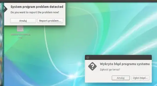

Today, upon logging in I saw an error message 3 times. First occured after entering my password on login screen, but before my desktop loaded (it appeared "on top of login screen"). Second message, appeared just after the login screen disappeared, and desktop started loading. The third message appeared when desktop finished loading.

Note: the first error message (in English) is the one that appears before logging in (and unless closed - it stays after login). The second error message (in Polish) is exacly the same error, but it appears after logging in and in correct language.
It seems like "before logging in" the system does not know which language I use, so it defaults to english.
error screenshot
