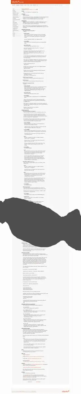

As an example how this kind of screenshot looks, here's an example of man xdotool on manpages.ubuntu.com, scaled down to 20% (original 1336x15653), done with the xdotool solution:
