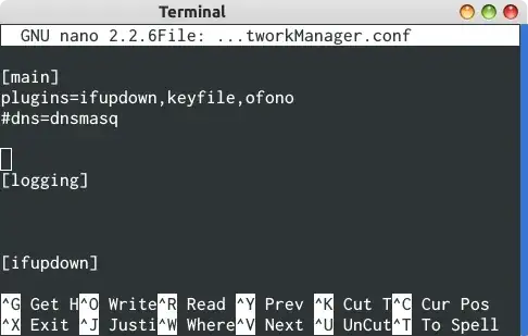

What you can try doing is open /etc/NetworkManager/NetworkManager.conf and comment out line dns=dnsmasq. Save and sudo service network-manager restart or reboot.
This basically is a line that tells Network Manager to use dnsmasq plug-in; commenting-out prevents Network Manager from using it. Referring to this post from Unix Stackexchange and this one from askubuntu, you'll get a hint that dnsmasq doesn't always do a good job.
Now will things be resolved without that line ? Sure. I have it commented out, and use OpenDNS , as set in configuration for my home network, and Google's public dns at school.
