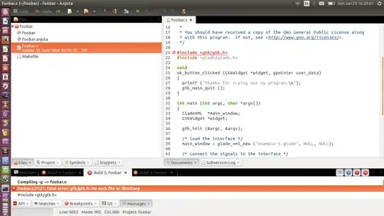

I know this question has been answered several times, I have tried each of them but still could not find the exact solution. I am starting to learn GTK + 3.0 with Glade User Interface. i know Glade will generate XML for the design and the same XML can be used in our c/cpp program. But to execute the program, one must have all the libraries installed or path must be set to the libraries in IDE's. I am using Anjuta IDE for developing this program whenever i tried to build the program I get the following error.
gtk/gtk.h: No such file or directory

Whenever I try to add Lib or External Lib, I am not able to add gtk/gtk.h file, The same file is already there in /usr/include/gtk-3.0/gtk/gtk.h and when I try to copy the same in libanjuta the same code still giving the same error, Any help will be highly appreciated friends, I am struggling lot to execute the program ..
