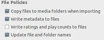

  • I delete them from Music in Banshee and from ~/Music (because I use these settings:
    and Banshee is copying them to ~/Music)
I now have the audiobooks in Audiobooks in the Banshee library and stored in ~/Audiobooks but the audiobooks in Banshee don't play. It seems that Banshee thinks they are still in ~/Music.

Try unchecking the first option, 'Copy files to media folders when importing'. If my guess is correct, this will ensure that you audiobooks stay where they are after importing.
