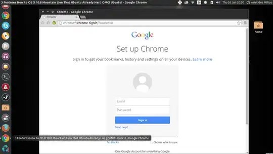

I would click on the "Google Chrome" icon in the Unity launcher, but even though it was there, another Chrome icon would pop up at the bottom of the launcher (the behavior of non-pinned running programs icons). Not only that, but the second icon would not have the proper right click menu, and also it's "name" (when hovering over the icon) is the tab that I had opened when things broke in the first place! Here's a screenshot illustrating this behavior:
Why would it do this to me!?
Look at the menu bar title and the icon title on the launcher, and note that there is already a chrome icon pinned.

I searched a little further and found THIS topic and after following the instructions to remove the .Desktop file it has reset back to the original right-click menu.
