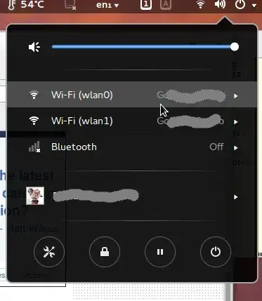

You can check if the new interface exists by typing
 sudo ifconfig -a
...and see if the wlan1 interface shows up. It will appear in the Network Manager too anyway:
