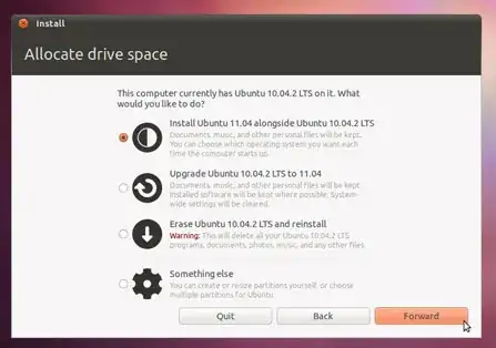

  7. Select using Install using entire disk on the Allocate Drive Space page although yours will show windows and may be Ubuntu. Select the use entire disk
    Sorting your hard drive
