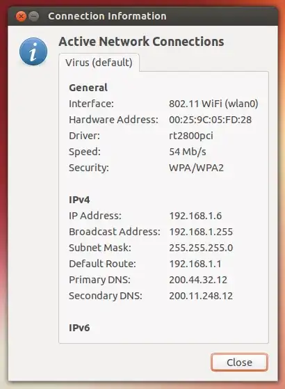

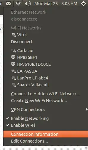

METHOD 2: In the top panel of Unity go to the Network Icon (Network Manager) and select Connection Information.
enter image description here You will see all the information including the IP (IPv4 and IPv6) of any device connected. In this case it is only showing one device since I have only one connected, but if I had multiple ones it would show each one on a different tab enter image description here
