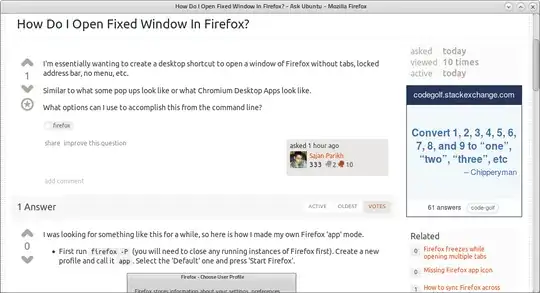

I'm essentially wanting to create a desktop shortcut to open a window of Firefox without tabs, locked address bar, no menu, etc.
Similar to what some pop ups look like or what Chromium Desktop Apps look like.
What options can I use to accomplish this from the command line?

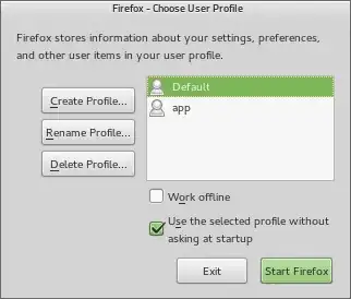

First run firefox --ProfileManager from terminal (you may need to close any running instances of Firefox first, or use the -new-instance option).
Create a new profile and call it app. Select the 'Default' one (IMPORTANT: otherwise by default it will start the app profile you are creating) and press 'Exit'.
Firefox Profile Manager

Now, when you run firefox -P app -new-instance http://URL (e.g. firefox -P app -new-instance https://askubuntu.com/q/487936/178596), you should get a Firefox window like this: Firefox window with only title bar
