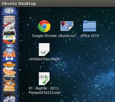

  • Icon theme was changed to some other icon theme. Icons

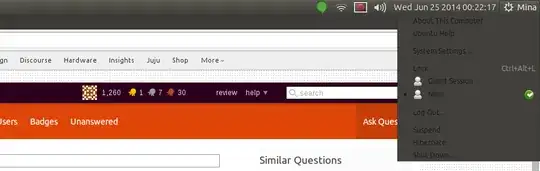

  • Some fonts are different like In Google chrome, fonts like "Hardware Insights Juju..." aren't supposed to be that thin. Also in the indicators' menus; you see it's not even readable and the icon for the language (that looks like this --> [EN] ) is missing. Fonts
