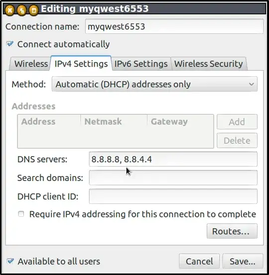

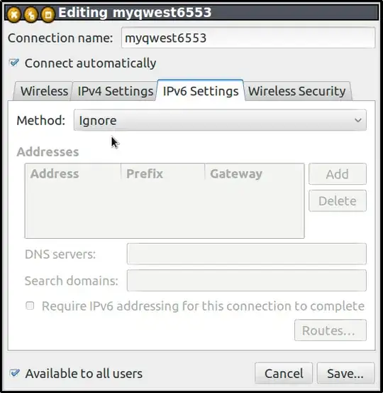

In network manager change your settings to match the screenshots. DNS SERVER IPV6
