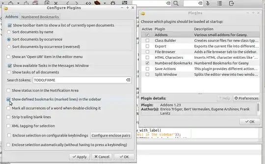

To add a list of these bookmarks, you have to install the Geany plugin "Addons":
sudo apt-get install geany-plugin-addons
To remember the bookmarks at each file load, the plugin "Numbered Booksmarks" is required:
sudo apt-get install geany-plugin-numberedbookmarks
(You have to save the file if you want save the bookmarks.)
After the installation, enable the plugin to load at startup:
Next step: Activate the bookmarklist -

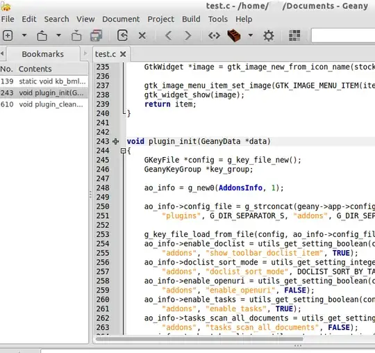

Bookmarklist example:

Bookmarks Sidebar does not update when bookmarked lines are moved up or down, using the current version of Addons. I reported this as a bug - and the response from the Geany team was immediate, so there's already a pull on SourceForge - which I've compiled and can confirm fixes it flawlessly. :-) I assume this'll be in the next release.
