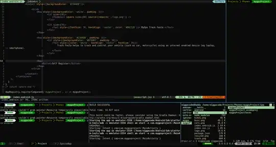

Here is an image of my code layout, which I only have to press (Ctlr + a -- as the modified mod key) and alt + c to get it starting.
tmux screenshot
