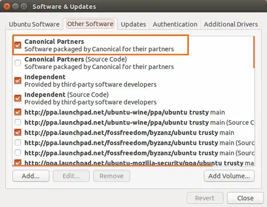

On ubuntu 14.04:
  1. Open software-sources by typing "software and updates" on the dash and open the application.
  2. On the "Other Software" tab, make sure that "Canonical partners" has a check mark besides it.
    screenshot for software and updates other software canonical vmware view client
  3. Now, add i386 architecture to dpkg by first opening a terminal (press Alt+F2 and typing terminal or pressing together Ctrl+Alt+t) and then typing the following:
    sudo dpkg --add-architecture i386
    and then enter your administrative password.
  4. Now, update your software package list by typing:
    sudo apt-get update
  5. And then install vmware-view-client from the same terminal by typing:
    sudo apt-get install vmware-view-client
