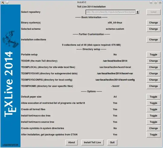

    • Add the -gui=perltk option to use a GUI installer. Install the perl-tk package first! (sudo apt-get install perl-tk) See the screenshot below how it should look like.

    Here's how the GUI installer looks like:
    install-tl
