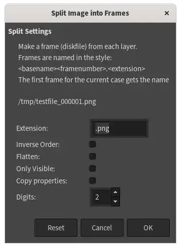

As an alternative approach to my previous script-based suggestion, I have finally discovered that you can also do this with one of the tools available if you have the GIMP GAP installed. (That's the Gimp Animation... Package? Plugin? Something like that.)
It's a bit hidden in the forest of GAP menu options, but the "Video" menu selection "Split Image to Frames..." will do so by saving each layer as an individual file. In whatever format you specify (via the file extension), and with several options for how to handle the layers. Here's the dialog that came up when I chose that option after saving an un-optimized animated GIF as a 52-layer /tmp/testfile.xcf:
Split Image into Frames dialog window
Despite the filename preview, the frames were saved as /tmp/testfile_01.png through /tmp/testfile_52.png, as specified. (It doesn't update the displayed string in response to your selections, but it does honor them.)
