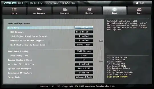

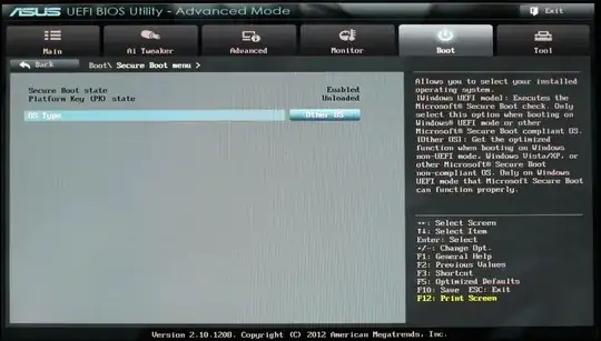

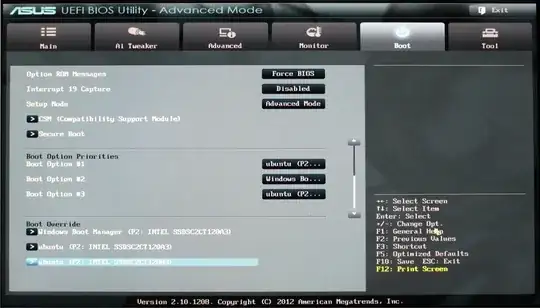

Enter the Advanced Mode and go to Boot. It should look similar to this:
enter image description here enter image description here enter image description here
Here you can disable or enable Fast Boot and other UEFI Booting releated options if needed.
If you installed Ubuntu correctly, there should be an entry called ubuntu. Try to boot that via boot override. If that works, you just need to configure the boot order properly.
If there is no such entry or similar, you probably have to either reinstall Ubuntu, register the bootloader via efibootmgr from a live media or install a default UEFI bootloader like gummiboot.
