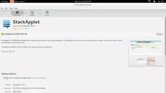

I recommend you to uninstall your original install of Stack Applet. Then, reinstall it using the Ubuntu Software Center as it is very easy and it worked perfectly for me. I did so in Ubuntu 14.04. enter image description here

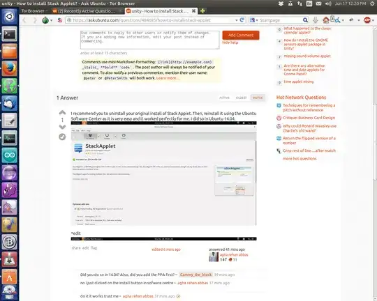

*edit enter image description here
I installed the latest version via ppa:stackapplet-dev/stackapplet as advised, just to find out the problem still resides in the code as I am writing this. A quick check shows the core of the problem you (and I) are experiencing: stackapplet is failing to authorize via the following URL:
http://stackauth.com/1.0/sites?key=_qlxmEAOH06hLA1_FsZIGQ&jsonp=jQuery1 … 4&_=1 …
The call results in a 404 - Not Found.
Until @nathan-osman (the author) fixes this, or someone else steps in to do the job, there is little hope in being able to use StackApplet.
For informational purposes, here’s a screenshot showing the 404…
