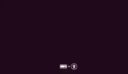

Start by booting your Live DVD or USB of Ubuntu.
Boot

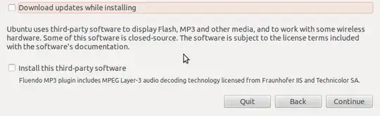

  2. Then, you will get the "Preparing to install Ubuntu" window. Here, I do not select any of those options. This way the installation is fast and after the installation when you are finally booted into your OS after the installation, then, you can install those extra softwares using the command:

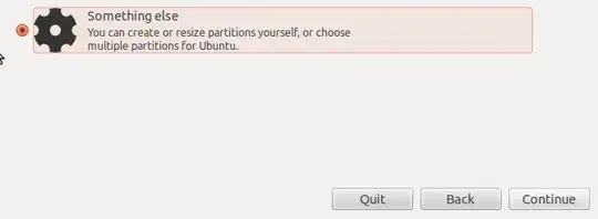

  3. After you are done with this you will get the "Installation Type" window. Here, select "Something Else".

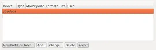

  4. Now, since you are doing a fresh install of Ubuntu therefore, erase everything, then click on "New Partiton Table".
    Disk

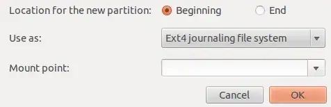

  7. Here, select the mount point as: "/".
