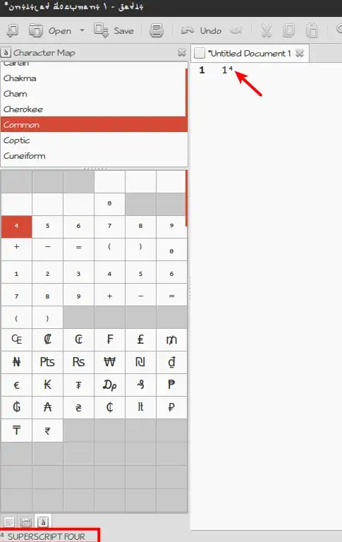

A Character Map plugin is available for gEdit. Enable the plugin in the Preferences. Enable the Side Pane in the View menu. Click on the Character Map icon at the bottom of the Side Pane, then choose "Common" and you will find the superscript 4 (even though it looks like am missing superscript 1-3). Below that are the subscripts and other special characters.
To use a certain character, just drag it from the character map on the Side Pane to the document. You can then copy-paste it in the right position.
From a question in the comments below:
After enabling the character map plugin, you can open/view the characters by click the icon that looks like a key with an "a" on it on the bottom left corner.
In my screenshot below, there are three icons in the Side Pane: The first is the documents icon to view all open documents, the second is the file browser for the file browser plugin and the third is the Character Map plugin.
Check screenshot below:
