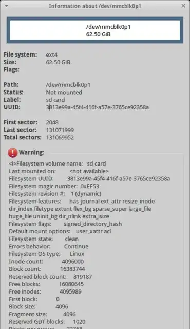

The SD card error that I see, is permission denied I cannot include a screenshot because I formated it and it ain't happening now but I can show you this screenshot, the sd card is formated to ext4 using gparted
It clearly shows that cannot write anything to the SD, as a regular user, I have to be root.

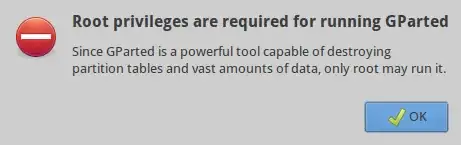

Edit after following sмurf's answer, I see

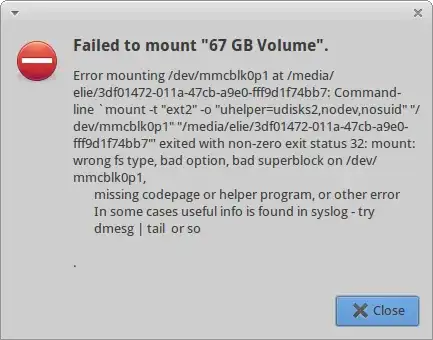

edit 2, gksudo solves few issues but when formating to ext4 I still see

To answer your question: You can not run gparted without sudo.
Your real problem however appears to be that an SD card formatted in Linux is unusable in an Android device because of a permission issue. You should be able to fix that by making the root directory of the card world writeable:
sudo mkfs.ext4 /dev/<YOUR_SDCARD_DEVICE>
sudo mount /dev/<YOUR_SDCARD_DEVICE> /mnt
sudo chmod 777 /mnt/.
sudo umount /mnt
Note: I haven't really tested that.
