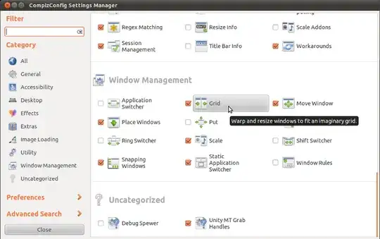

Choose Grid from Window Management:

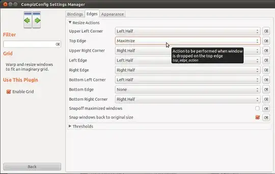

and adapt the window's grid behaviour to your needs:

It's the grid plugin in ccsm, deactivating it removes this feature. Or there are options to make it not maximise when dragging to the top but it will still fill one side of the screen when you drag it to that side.
Luke
  • 111
Just disabling the grid in the Compiz manager did not solve this for me.
I also had to use gconf-editor to uncheck: / -> desktop -> cinnamon -> windows -> edge_tiling.
After that, windows were no longer snapping to fullscreen.
