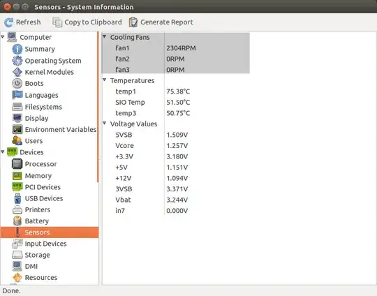

16
Try using HardInfo which is very useful GUI application to know all information about system & hardware.
Install HardInfo by sudo apt-get install hardinfo
Here is screen-shot where fan info is displayed.
screen
Hope this helps.
